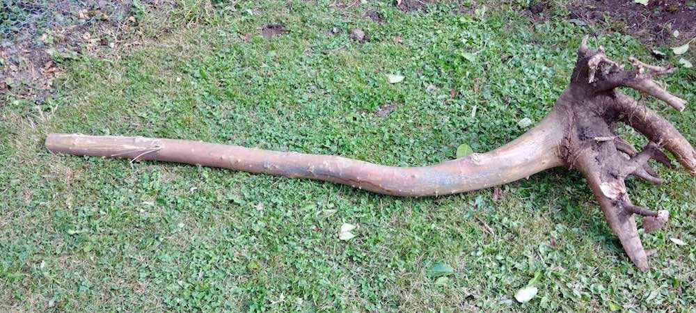

Tree trunk with its roots
Step 1 – The choice of the branch (or the trunk!)
