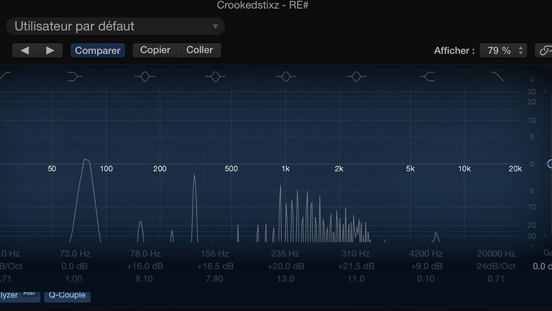

I suspected that this theory could be tedious. So I prepared something to stretch your brain. Here, for example, is what the frequency spectrum of a D didgeridoo from Crookedstixz looks like.
We can see very clearly, four first peaks starting from the left.
We just studied these first four harmonics. We have the fundamental, which I remind you, is the note of the didgeridoo (in D here) then the harmonics that follow.
Here’s the same diagram that shows you what these frequency peaks correspond to.
Harmonic 1 = about 73.42Hz = D, referring to the table above, we see that this is indeed the note of our didgeridoo.
Harmonic 2 = 73.42Hz x 2 = about 146.84Hz = octave = D
Harmonic 3 = 73.42Hz x 3 = about 220.26Hz = Fifth = A
Harmonic 4 = 73.42Hz x 4 = about 293.68Hz = Fourteenth = D
